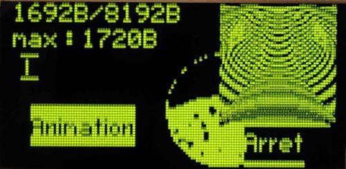

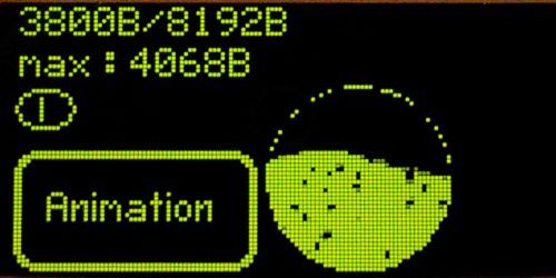

However, for everything to work well I need to use MEMDEV.

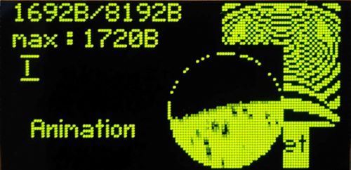

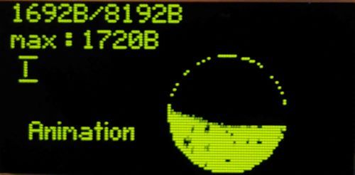

If I don't configure a MEMDEV, emWin does not show me all the elements.
The animation works but when I hide window n°2, only the animated part of window n°1 hides window n°2
The window n ° 2 is of dimension 45x64
I would like to know, if I don't want to use a MEMDEV, do I need a specific setting? I have been searching for several days, without results, and I cannot understand why such behavior.
