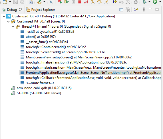

Hello, In my project I have 2 screen, Lets call it SCR-1 and SCR-2. First SCR-1 will be displayed for 1 sec and post SCR-2 will be displayed all time. Everything works fine till thn.
In my project sometimes, I need to again put SCR-1 (with SCR-1 for 1 sec and thn SCR-2) during run time. When I try to do same, I am facing assert function. So screen is able to successfully change from SCR-2 to SCR-1 but post 1 sec while trying to go for SCR-2, touchgfx is going for assert.
Below are the stack information. Here SCR-2 is main screen

2021-01-08 3:09 AM
I solved issue by removing customized widget during tearDownScreen.
2021-01-08 3:09 AM
2021-01-08 8:14 AM
Maybe better is change order in setupScreen, good practice is call as first
MainScreenViewBase::setupScreen();
2021-01-08 8:25 AM
Sure I will make that change. Thanks
