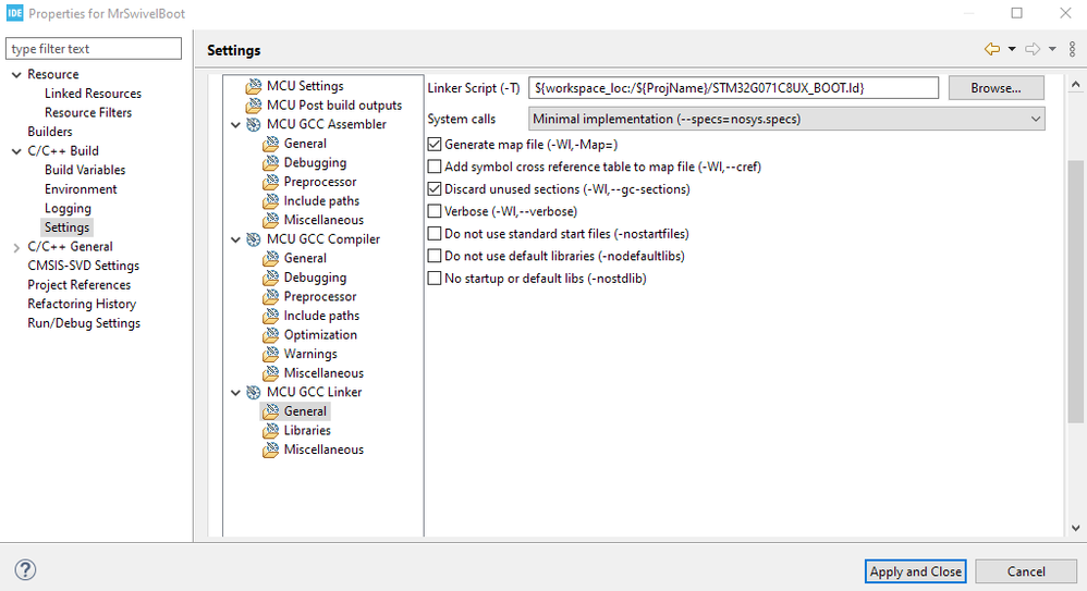

2021-03-18 10:24 PM
Hard to find. Just incase you still struggling and for those in are new:
In this example, Make sure Linker has STM32....._FLASH.ld
