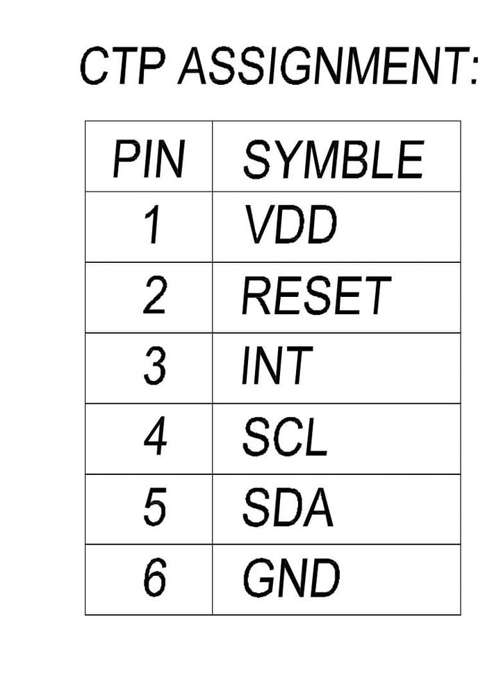

Dear Expert,
I am using RK043FN66HS-CTG in my device as a manufacturer.
However, there is Supply issue at manufacturer issue and as such I am looking at an immediate alternate.
I have found some models from Tianma Corp. similar to my 4.3 TFT LCD but the pin is different and doesn't comply to my pcb.
I am in big problem I cant change my design all of a sudden and as per market available LCD+ TP.
Can anybody in this community help me to find my exact CTP match in any LCD maker in this world.
Any solution for this is highly recommended.
MY PIN as attachment below..
