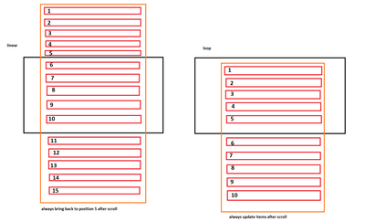

That sounds like a perfect job for the scroll list widget .
As you can have thousands of music, it would be appropriate to limit the number of elements in your scroll list and to update these elements to reflect the current music to display.
I see 2 ways of doing that :
Here is a bad illustration of it:
It is important to have more elements than what is visible to allow for proper updating during the scroll, because updating the elements can only happen once the scroll is finished (as far as I know).
I hope this helps.
