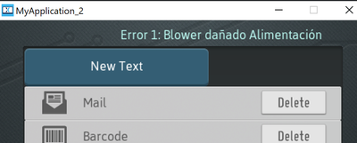

I am wanting to display a text that changes over time what it says, this works fine but for some reason the letters with tilde or the Ñ does not appear.
I put a picture of how I set the typography and how it is shown badly written in the simulation.
in “wildcard characters” I added áéíóúÁÉÍÓÚñÑ and in “wildcard ragne” I put ,Á-Ú,á-ú,ñ-Ñ but it did not work.
why does this problem occur?
Error 1: Blower dañado
Error 6: Alimentación insuficiente (it was cut off by the scrollablecontainer, it doesn't matter)
Error 12: Unidad no respondía

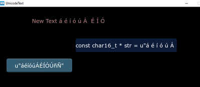

Hi @Maximiliano
Prefix the string with 'u'
Unicode::snprintf(texto_errorBuffer, TEXTO_ERROR_SIZE, "%s", u"Ñá");
texto_error.invalidate()I attached example project.

Just to clarify for anyone else reading this:
with wildcard ranges:
a-z,A-Z,0-9,Á-Ú,á-ú,ñ-Ñ
it's ok, you don't need to put in wildcard characters.
