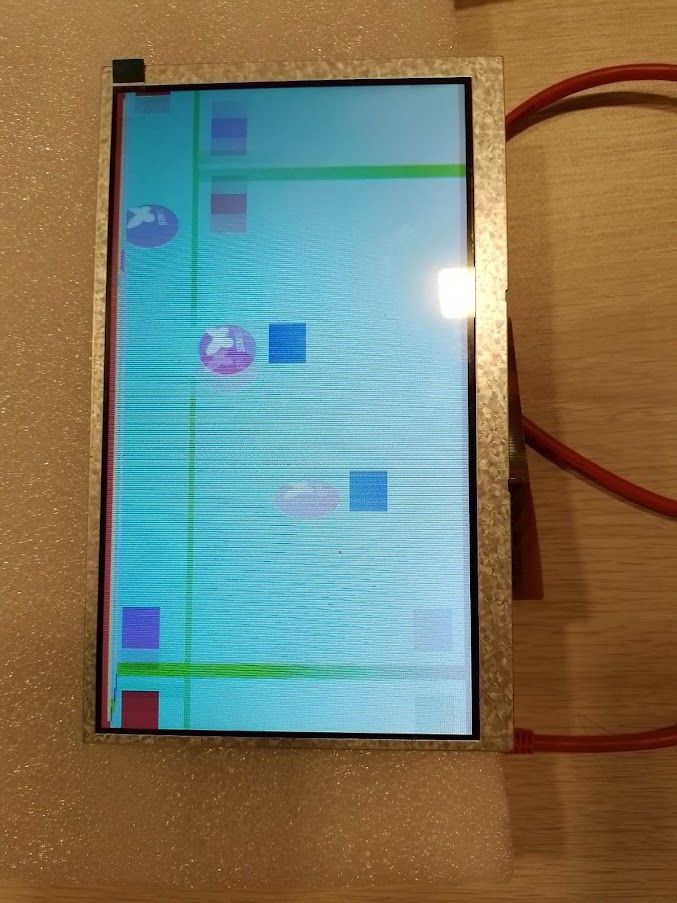

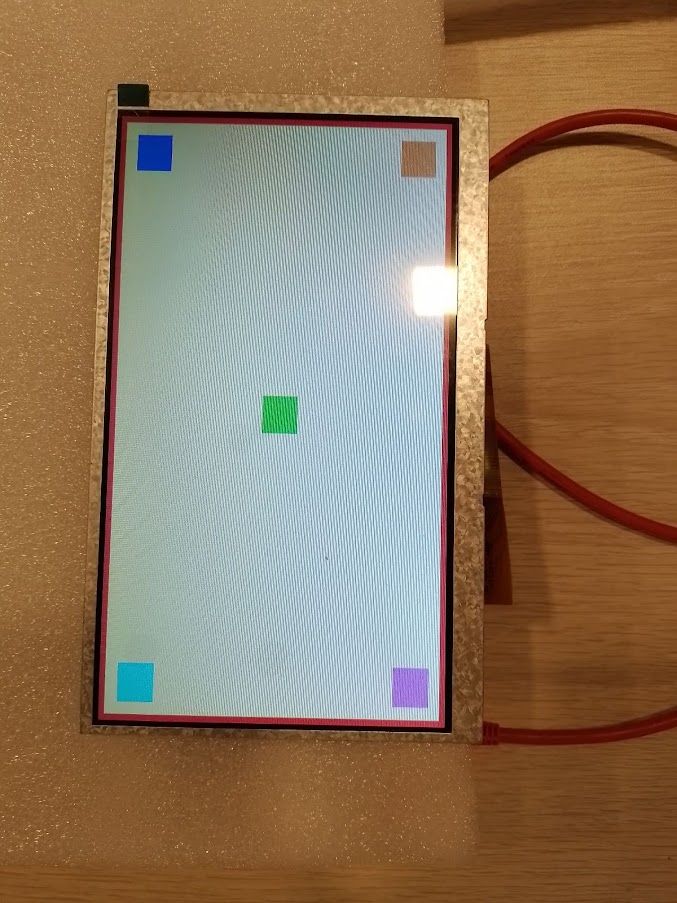

I'm trying to use 7 inch TFT display with STM32F750-DK discovery baord. I have replaced inbult 4.3 display by disoldering and soldering new display. I'm using application template from TouchDesigner designed for 4.3 display. I have done the necessory LTDC configurations from CubeMX by follwing this forum answer and the display datasheet.
Also change the start address 2 to match with 24*480*800 bits under "Display" configurations in "Touchgfx Mode and Configration" in CubeMX. Finally abled to display some static screen like in the 1st image bellow sucessfully.
But the problem is when I inserted a animated imaged display got jumbled and going crazy like in the 2nd image bellow. I just add one animated image to the sceen in my 1st image.
What could be the reason for this wired beharvour only happens with animations. This animation woking in simulator without any issue
P.S. I'm facing some wired display item misplacement when transistion between 2 static screens as well. Seems like issues come wehne something change in the display
Thank you
2023-04-07 3:03 AM
Configure board for big resolution displays isnt so simple.
If you use project for 480x272 and change to 800 , you need many changes. Better is start new project for your config from IDE. But ok you dont show an setup here, then only some tips.
Change start address2 is better set to next sdram page start ... And config by address
Dot clock need change to x3 or x4 (LTDC clock)
Interrupts and priority for RTOS...
What version TGFX ?

2023-04-09 11:50 PM
Try 30MHz
2023-04-10 4:32 AM
Checked with 30MHz but no luck. Also tried setting frame buffer address to 0xC0400000. But not sure about the page start. What I did was adding Bank size (4MB) address space to the start address. Unfortunatly unable to find how pages are organised in the memeory. But I think adding 1 bank slot should be start with a new page.
2023-04-25 9:11 PM
Found another thread he also haveing that same issue. https://forum.allaboutcircuits.com/threads/stm32f750-800x480-lcd-causing-artifacts.192298/
Seems like there is a issue with the STM32F7508-DK devlopment board.
Also able to drive a 800x480 display using STM32H750B-DK board by just doing paramter changes in LTDC parameters in CubeMX without modifying the code manually.
