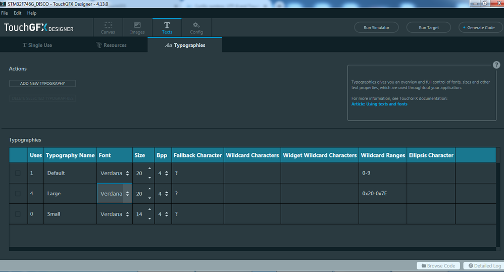

Did you set Text ->Typography-> WildCard ranges as below for textArea1Buffer ?
Hope this helps..
Karan

No.
This is my options. Without any effect
Do you able to see A-Z in Text Area? ​
Yes. I see all symbols, excluding cyrilllyc.
Cyryllic symbols are replaced by "?".
Impotrtant: one cyrillyic symbol replaced by two "?".​

Check your generated files to see if those unicodes have even been geenrated. For instance, here's generated/fonts/src/Font_Verdana_10_4bpp_0.cpp with the pixel data for a single glyph 0x003F. If touchgfx cannot find your glyphs in the generated files then it will display "?" (if you chose a fallback character).
#include <touchgfx/hal/Types.hpp>
FONT_GLYPH_LOCATION_FLASH_PRAGMA
KEEP extern const uint8_t unicodes_verdana_10_4bpp_0[] FONT_GLYPH_LOCATION_FLASH_ATTRIBUTE =
    // Unicode: [0x003F, ]
    0xD2, 0xCE, 0x03, 0x21, 0x50, 0x0C, 0x00, 0x30, 0x0C, 0x00, 0xC1, 0x05, 0x00, 0x4D, 0x00, 0x00,
    0x0C, 0x00, 0x00, 0x02, 0x00, 0x00, 0x0F, 0x00
