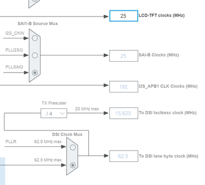

2024-05-09 5:18 AM - edited 2024-05-09 5:37 AM
The lane byte clock is set 62500 Khz
The pixel clock is set to 27429 Khz
if(Lcd_Driver_Type == LCD_CTRL_NT35510)
VidCfg.HorizontalSyncActive = (NT35510_480X800_HSYNC * 62500U)/27429U;
VidCfg.HorizontalBackPorch = (NT35510_480X800_HBP * 62500U)/27429U;
VidCfg.HorizontalLine = ((Width + NT35510_480X800_HSYNC + NT35510_480X800_HBP + NT35510_480X800_HFP) * 62500U)/27429U;
in debuger check values calculated here , too clock ltdc is real 27.429MHz ? And is max DSI speed required?

2024-05-10 11:51 AM - edited 2024-05-10 12:20 PM
I ask if in clock config you have this numbers as in code
but we can end this conversation with explain. This display work ok with portrait refresh because controller NT reads GRAM and shows data on display filled in memory from video mode traffic. Tearing here may occur but is line type on place where data is read and writed same time (protected with some buffer or GRAM bidi). But when GRAM is filled in landscape order and read in portrait tearing is angle line type diagonal and visible (protect rw not work here)
