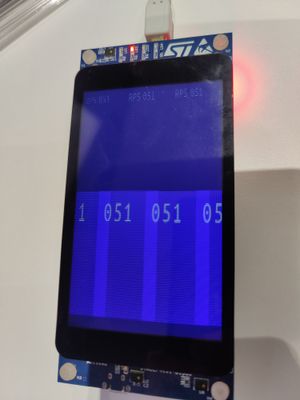

Feeding a landscape data stream to the screen when the register is set to portrait ends up looking very broken as below (as I would expect):

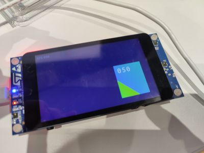

Whereas switching the register to landscape the same data feed renders like this (complete with the diagonal glitch that we're talking about):
This makes it seem to me like the display thinks it can support a landscape data stream, but actually is not able to do so properly, causing the diagonal line.

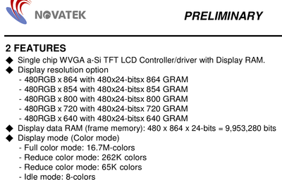

As you can see is portrait native
but with GRAM, then config can handle this display too as landscape... I wrote for example , then exist displays that only support native configs. In your config with DISCO you must have other mistake with diagonal trouble.
