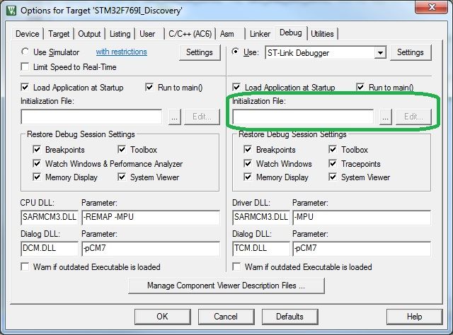

2021-02-18 12:53 PM
The H7 is significantly more complex, that things works on the F7 is practically irrelevant to solving the problem here.
All instances here it is failing at the download/debug stage not the build stage.
Salient things to post would be the .AXF file, .MAP file, and the .UVOPTX file
What version of Keil MDK is being used? 5.33 is current
What STM32H7 pack is installed?
What version of CubeMX is being used? 6.1.1 is current
Focus on what's physically failing. All the signs point to QSPI, whether its the lack of a loader, or the debugger touching the memory.
