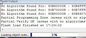

NEXT STAGE
Than I edit project in TouchGFX editor, add one button, generate code, and build it in KEIL.
Than I download it to flash.
Then starting debug I get error, on this stage
this error
this error is not occured when I delete from H743.sct this code

2021-02-12 10:14 AM
This question is into KEIL support and not ST bug. But i mean KEIL is good, but for example debug with more configs is impossible, attach to running MCU is one miracle and price for unlock is ...

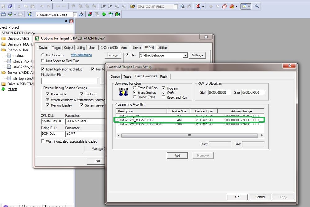

2021-02-12 11:01 AM
You need to select a Flash Algorithm for the external QSPI Flash

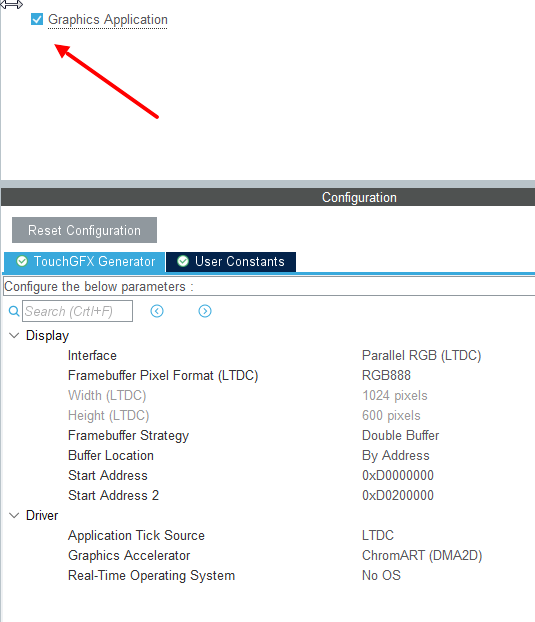

2021-02-15 4:52 AM
I havent downloaded you project (not really allowed to, shady link), could you give more info on how you configured TouchGFX in your project ? If you look at the application template available in TouchGFX Designer for the H747-eval, you can see in the folder /projectName/TouchGFX/target files that we have set ourselves. Those are not generated by TouchGFX Generator. There are more steps involved than just setting it in CubeMX.
/Romain
