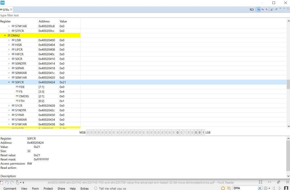

2020-05-24 2:03 PM

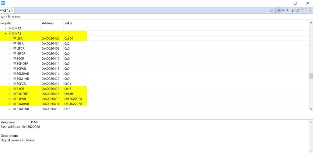

DMA2_S1CR is suspiciously set to byte transfer on both ports. You did not show us the FIFO control register for stream 1.
Can't this be consequence of the infamous "DMA needs to be enabled first" bug of the older CubeMX versions?

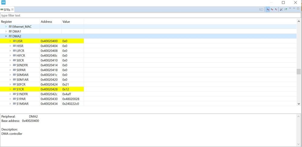

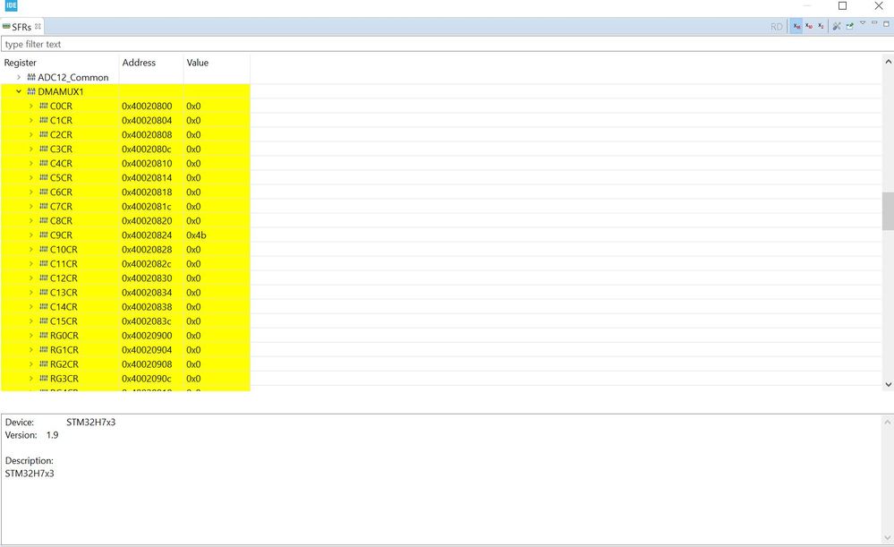

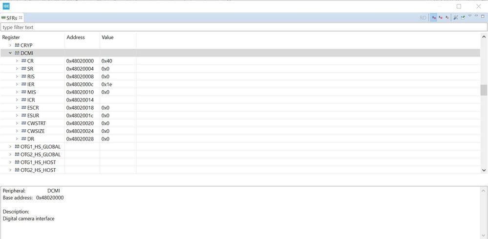

Please post the contents of the DMA, DMAMUX and DCMI registers before and after starting DMA.
2020-05-14 2:32 PM

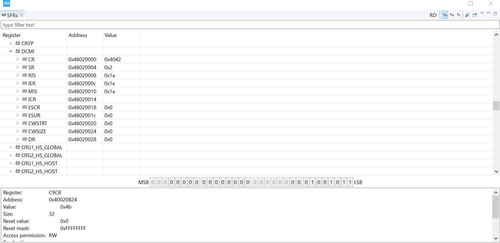

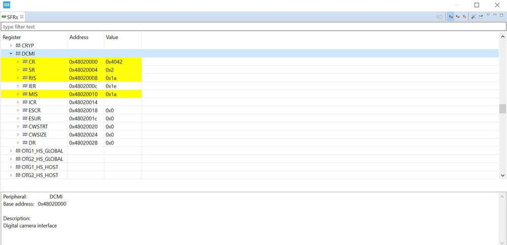

Hello
Thanks for your response. I am attaching following register values (also via zipped folder).
My compiler allocated the `frame_buff` at `0x240222c0`, which is observed also in the DMA registers.
Please notice the register values -
before request:
after request:
snapshot while in DMAError:
I noticed I get the `HAL_DCMI_VsyncEventCallback` + `HAL_DCMI_LineEventCallback` + `DCMI_IRQHandler` irq's but still, no data appending to the `frame_buff`.
Any idea what can result the problem?

2020-05-24 2:03 PM
2020-06-14 11:16 AM
Initiating the DMA before the DCMI (initialization sequence) solved the issue.
