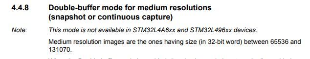

For DCMI High resolution, you should use the Double-buffer mode.
But, the Double-buffer mode is not available in STM32L496 devices.
You can refer to the section "4.4.8 Double-buffer mode for medium resolutions (snapshot or continuous capture)" in this AN5020 Digital camera interface (DCMI) on STM32 MCUs
