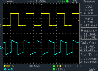

The problem I am facing here is that DCMI capture rate is not as same as VSYNC signal.
In continues mode, When VSYNC frequency is 50Hz, DCMI captured fieldrate is 40Hz.
I had placed a toggle pin at VsyncEventCallback and FrameEventCallback to detect their rates. Yellow one represents Frame(field)rate while the blue one represents VSYNC frequency.
