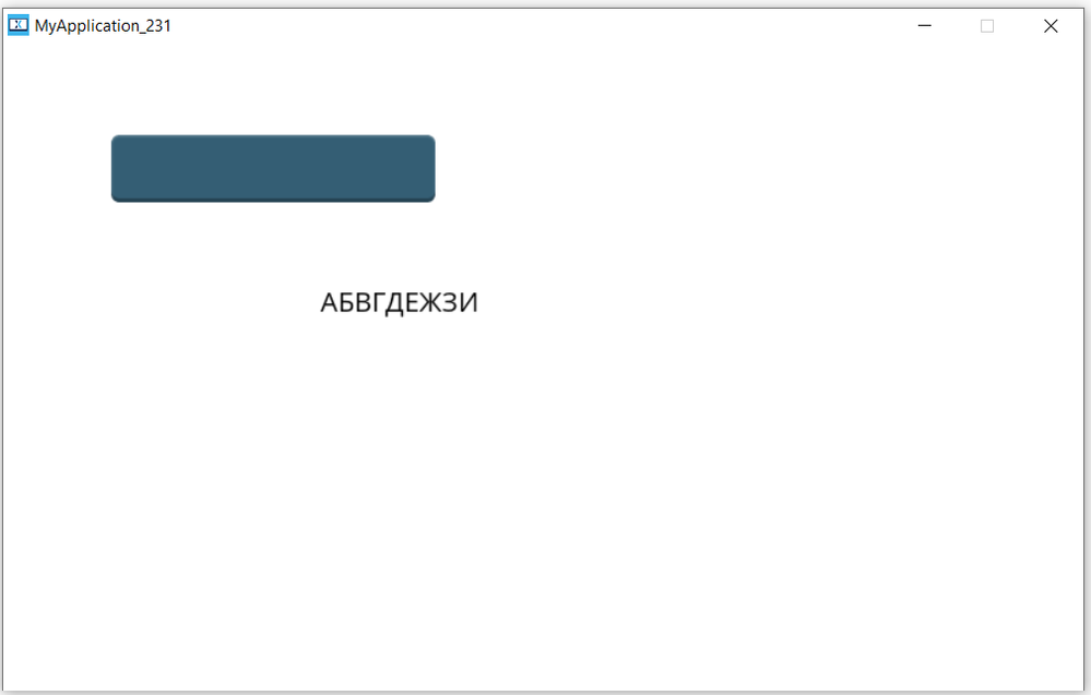

For the range, based on this website the range should be something like this: Ѐ-ԯ (0x0400 to 0x052F)
So you can put this as a wildcard range value (either in letters or the Unicode).
Also, you can't use the Cyrillic letters in your code directly without converting it into Unicode because your C++ code is encoded in UTF-8.
To use them, you can convert your string like this :
void Screen1View::fillText(){
const uint8_t* Mystring = (const uint8_t*)"�?БВГДЕЖЗИ";
Unicode::fromUTF8(Mystring, textArea1Buffer, TEXTAREA1_SIZE);
textArea1.invalidate();
/Osman

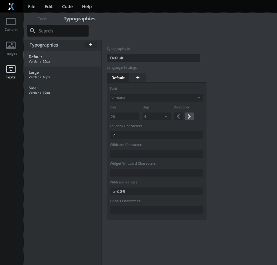

Since you are using wildcards in your TextArea, you also need to specify the characters and data you wanna pass to your wildcard. For that, go to TouchGFXDesigner > Texts > Typography, then select the typography you are using for your wildcards and fill the Wildcard Ranges section.
E.g. if I want to pass both latin alphabet letters, and numbers to the wildcard :
I'm not sure that will resolve all the problems, but could be something that you forgot to do.
Hope it helps,
/Yoann

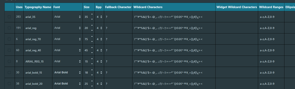

My situation is the following for the textArea4
So if i am understanding right i have to check arial_bold_20..
This is my situation
Is it correct ?
Shall I change something here ?
Thanks for the support
2023-04-26 6:11 AM
I think that you have to put your cyrillic alphabet "first letter-last letter" in the Wildcard Ranges pane.
You also have to ensure that the font you use (here Arial Bold) supports the characters you want to display.
/Yoann
