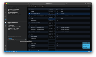

You can also manage system and project bundles in VSCode interface through the Bundles Manager:
