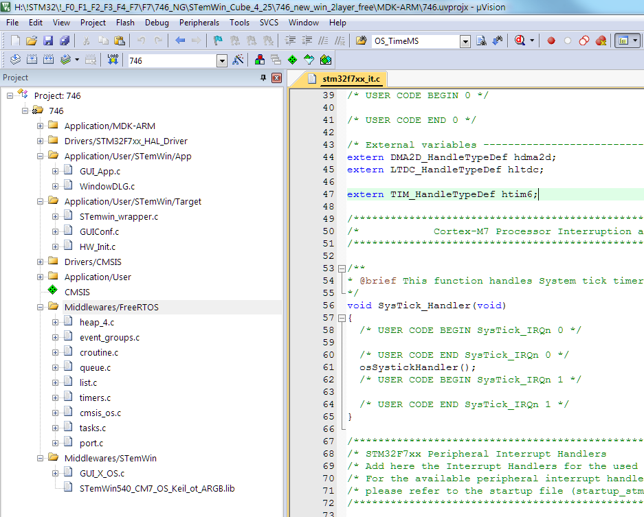

I made a project for CubeMX 4.25 + STemWin with 746Discovery (default config setting from CubeMX).
Everythingis well. (Keil 5.25 compiler)
I add FREERTOS to project (1 task with default setting)
After compiling I have error
linking...
746\7axf: Error: L6218E: Undefined symbol OS_TimeMS (referred from stemwin_wrapper.o).Searching for 'OS_TimeMS'...
H:\!STM32\!_F0_F1_F2_F3_F4_F7\F7\746_NG\STemWin_Cube_4_25\746_new_win_2layer_free\STemWin\Target\STemwin_wrapper.c(85) : extern volatile GUI_TIMER_TIME OS_TimeMS; H:\!STM32\!_F0_F1_F2_F3_F4_F7\F7\746_NG\STemWin_Cube_4_25\746_new_win_2layer_free\STemWin\Target\STemwin_wrapper.c(876) : OS_TimeMS++; Lines matched: 2 Files matched: 1 Total files searched: 148A similar situation for F4..
#freertos #cubemx #stemwin Note: this post was migrated and contained many threaded conversations, some content may be missing.Solved! Go to Solution.

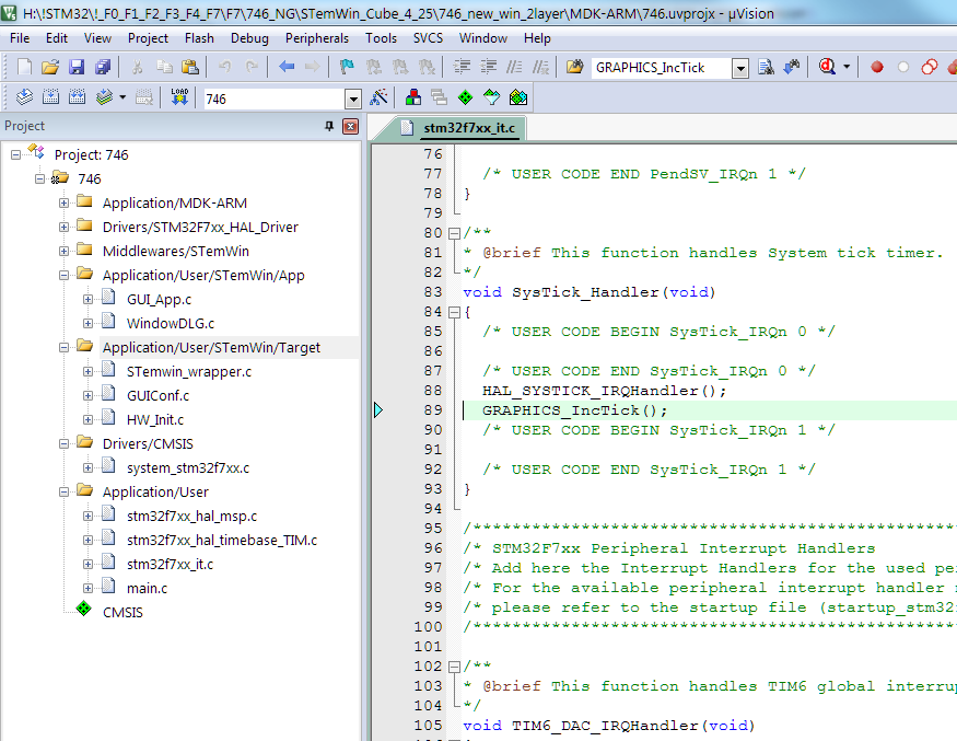

2018-05-23 5:47 PM
Imen,
Thank you for attention.
CubeMX have to add GUI_X_OS.c to project with FREERTOS and delete GUI_X.c from a project
It is my no RTOS project
IT is FREERTOS project
For no RTOS project
H:\!STM32\!_F0_F1_F2_F3_F4_F7\F7\746_NG\STemWin_Cube_4_25\746_new_win_2layer\STemWin\Target\STemwin_wrapper.c(85) : extern volatile GUI_TIMER_TIME OS_TimeMS;H:\!STM32\!_F0_F1_F2_F3_F4_F7\F7\746_NG\STemWin_Cube_4_25\746_new_win_2layer\STemWin\Target\STemwin_wrapper.c(876) : OS_TimeMS++;H:\!STM32\!_F0_F1_F2_F3_F4_F7\F7\746_NG\STemWin_Cube_4_25\746_new_win_2layer\Middlewares\ST\STemWin\OS\GUI_X.c(59) : volatile GUI_TIMER_TIME OS_TimeMS;H:\!STM32\!_F0_F1_F2_F3_F4_F7\F7\746_NG\STemWin_Cube_4_25\746_new_win_2layer\Middlewares\ST\STemWin\OS\GUI_X.c(73) : return OS_TimeMS; H:\!STM32\!_F0_F1_F2_F3_F4_F7\F7\746_NG\STemWin_Cube_4_25\746_new_win_2layer\Middlewares\ST\STemWin\OS\GUI_X.c(77) : int tEnd = OS_TimeMS + ms;H:\!STM32\!_F0_F1_F2_F3_F4_F7\F7\746_NG\STemWin_Cube_4_25\746_new_win_2layer\Middlewares\ST\STemWin\OS\GUI_X.c(78) : while ((tEnd - OS_TimeMS) > 0);Lines matched: 6 Files matched: 2 Total files searched: 120
For FREERTOS project
H:\!STM32\!_F0_F1_F2_F3_F4_F7\F7\746_NG\STemWin_Cube_4_25\746_new_win_2layer_free\STemWin\Target\STemwin_wrapper.c(85) : extern volatile GUI_TIMER_TIME OS_TimeMS;H:\!STM32\!_F0_F1_F2_F3_F4_F7\F7\746_NG\STemWin_Cube_4_25\746_new_win_2layer_free\STemWin\Target\STemwin_wrapper.c(876) : // OS_TimeMS++;Lines matched: 2 Files matched: 1 Total files searched: 148Probably the OS_TimeMS generated by CubeMX needs to be removed from FREERTOS project?
