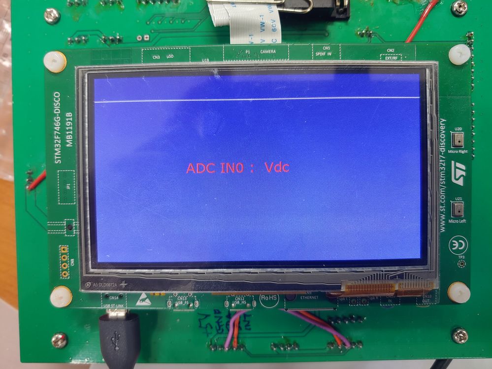

I watched YouTube and followed it. This is to display the voltage coming into ADC IN0 on the LCD.
I used the TouchGFX + CubeIDE compiler, but an error occurred.
On YouTube, it compiles normally. Please let me know why the error occurred.

I saw your YouTube and tried it. However, some errors have occurred.
Some variables are not declared, how can I solve them?
void Screen1View::analogUpdate(uint32_t value)
memset(&textAreaADBuffer, 0, TEXTAREAAD_SIZE);
Unicode::snprintfFloat(textAreaADBuffer, sizeof(textAreaADBuffer), "%.3f", value * 0.000805664 ); // 3.3/4096 = 0.000805664
textAreaAD.invalidate();
I tried to display the analog input voltage on the LCD screen, but an error occurred in the screen viewer function. The problem made me sick for a week. I want to upload a proper YouTube. The person who uploaded YouTube wants to upload in detail how the error did not occur.
Can someone please help me.

ADC values are still not updated.
When it's time, watch YouTube.
I want to know if I get the same result.
Please Help.
