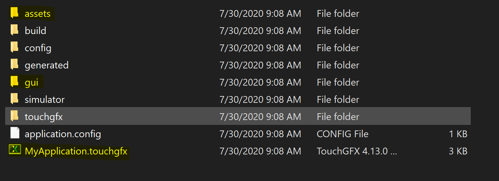

You enclose a zip file to your message. You can see a paperclip logo below the message box of your post, that allows you to enclose the zip file.
The only folders that are necessary in the archive are the ones in yellow in the image below. The other folders can be deleted.
/Alexandre
