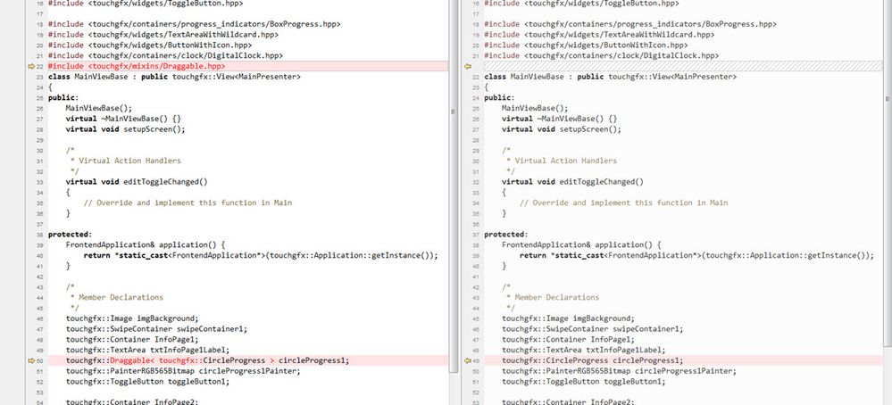

I'm looking to create a user interface that will allow my customers to modify their displays at run time, but I don't want to make it by default. I'd like to be able to have the users first toggle an edit button before allowing them to modify the position of controls/widgets.
I see that it's actually a different class that is chosen at design time.
