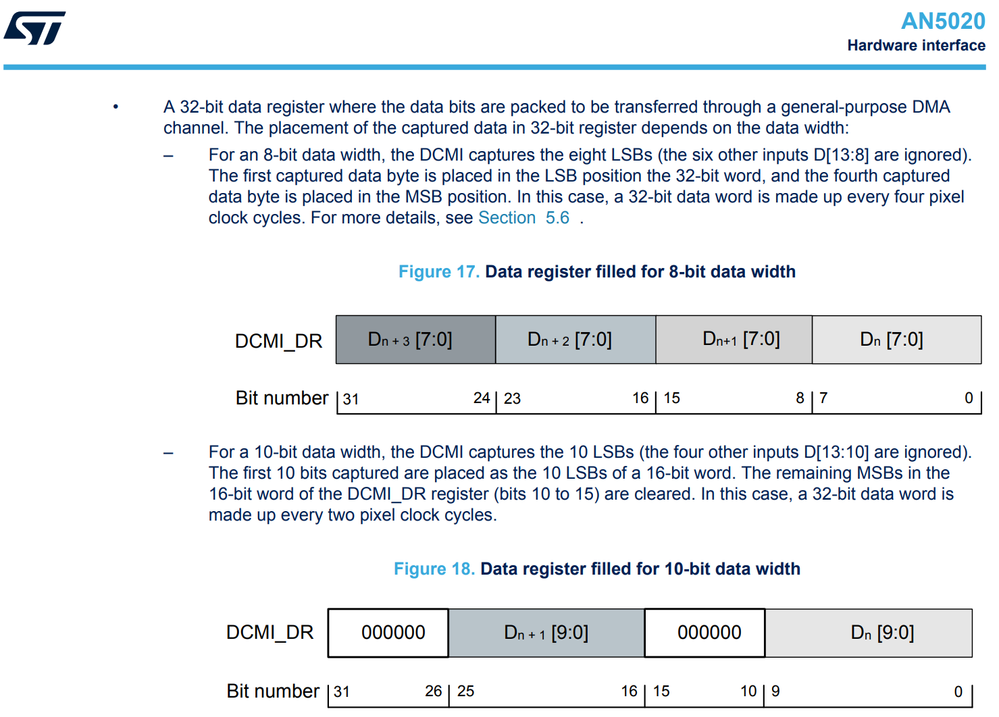

I am not sure if this helps but you may need to check AN5020. Hope this helps!
2023-03-07 8:22 AM
Thanks, but no, this does not explain how to store D[9:2] to form 8-bit image in memory.

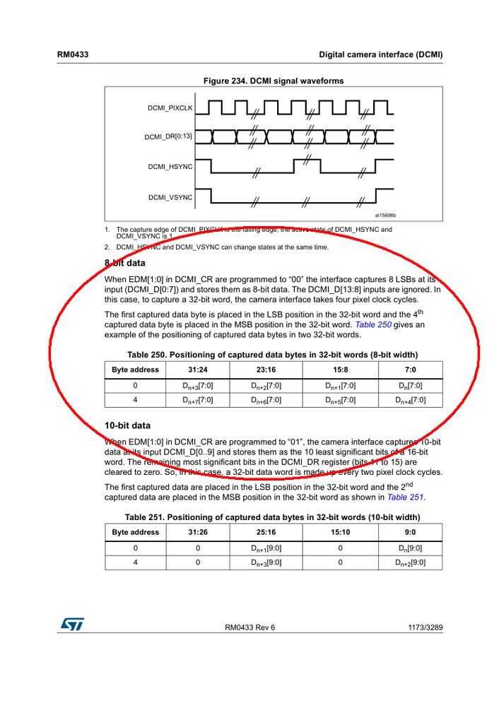

> No, because the pins DCMI_D[0] and DCMI_D[1] are the least significant bits. So I need to keep DCMI_D[9:2] when using 10-bit interface, not DCMI_D[7:0] as presented in the docs.
> The DMA/DCMI would have to be able to perform logical shift right by 2 bits to remove them
If you can't find it in RM, it's not there.
Meantime, couldn't you simply connect camera's data pins 2..9 to mcu's data pins 0..7?
2023-03-07 8:41 AM
Well if the peripherals don't support it, I cannot do anything about it. I would have to desing a new PCB for the CMOS sensor to solve it by wiring the interface as you suggest.
