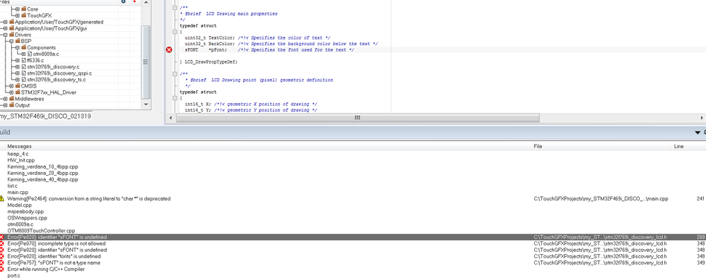

Hi. Following this document:
https://touchgfx.zendesk.com/hc/en-us/articles/360020208091-Configuring-STM32F769I-DISCO
and believe all the required changes have been made including applying comments to exclude the STM32 fonts as per this article. However, IAR compiler is raising font related errors.
Any suggestions for a fix? Will review this procedure again to hopefully locate my fault but welcome all feedback. Thanks.

Hi @Mon2,
I will double check the article. From your compiler errors it looks like either an include is missing or some code is there that shouldn't be (We do not use or need the standard drawing methods provided by _lcd.c)
You could try to simply remove that code for now that the compiler is complaining about. If it's related to lcd drawing methods (sFont, drawRect, etc) you can just ommit it since it is not used by TouchGFX.
Sorry for the trouble!

Thanks @Martin KJELDSEN. Removed a file that we may have added in error and somehow hacked our way into an error free compilation but generating a black screen on the display. If we launch the TouchGFX tool as a stand alone, the gcc generated code works fine (although the touch response with a decay timer to fade the posted graphic appears to be quite slow with 3000ms steps). Regardless, the display works and the 2 graphics with touch access are operating correctly.

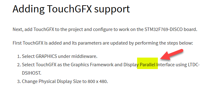

In the project add a sub-group under Drivers called BSP and add the three files stm32f769i_discovery.c, stm32f769i_discovery_qspi.c and stm32f769i_discovery_ts.c which is located in STM32F7Cube installation folder, [STM32F7Cube]Drivers/BSP/STM32769i-Discovery and the file ft5336.c located in [STM32F7Cube]/Drivers/BSP/Components/ft6x06 ???
No such option - should read as "Serial"

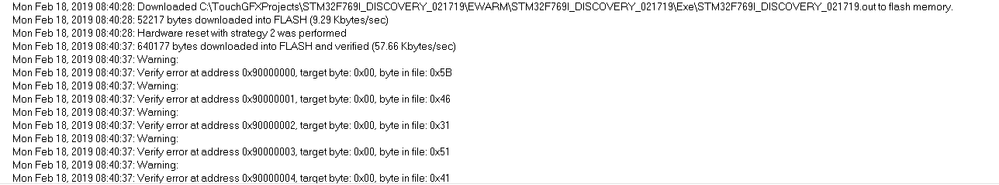

3) ST Link utility does not appear to access the QSPI flash. While we can upload the .hex file that is generated by IAR using PROGRAM, the external QSPI flash reports that the file is out of range. Will study the Intel hex file to see if the range of the QSPI is included.
22:17:10 : [STM32F769I_DISCOVERY_021719.hex] opened successfully.
Address Ranges [0x08000000 0x0800CBCD] [0x90000000 0x9008F8B8]
22:17:10 : [STM32F769I_DISCOVERY_021719.hex] checksum : 0x04036EBD
22:17:22 : Memory programmed in 8s and 721ms.Does the above confirm that the QSPI region has been programmed?
We have added the onboard QSPI flash as EXTERNAL LOADER but how do we upload to this memory region using the IAR compiled code?

"ST Link utility does not appear to access the QSPI flash. "
You must add the external flashloader for your board manually. I think you said you did this? Then it will recognize that it can program 0x90000000->. Are you sure you've added the right flashloader?
