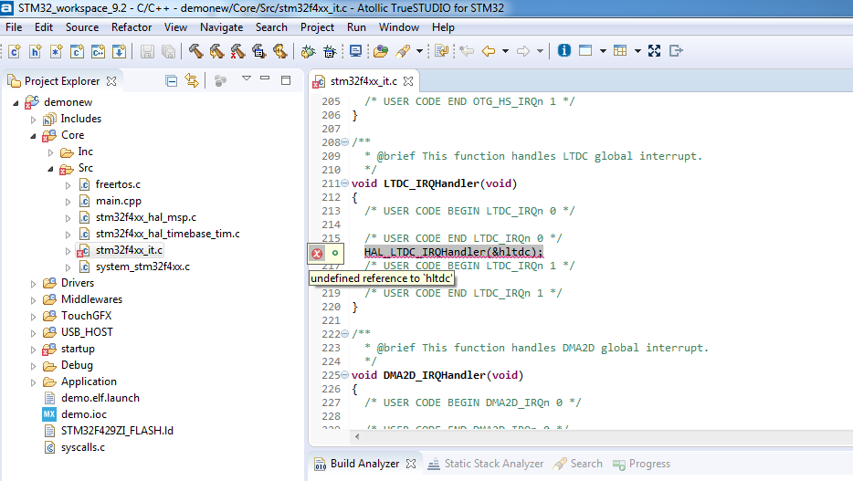

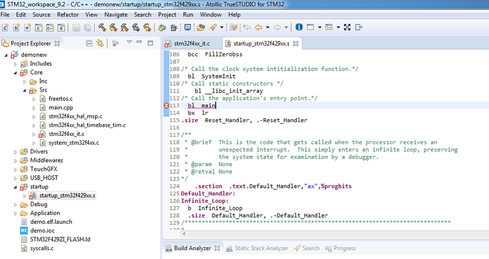

We are working on STM32F429 Discovery board.
Following are the steps we followed to create a project in TrueStudio using CubeMX and TouchGFX
But this results in compilation and linking errors as shown in below screenshots
Please help me with the solution to above errors
UPDATE:
One more change I did in testing today.
RESULT: Same compilation errors as above
There are no compilation/linking errors without GRAPHICS enabled.

The TouchGFX+CubeMX+TrueSTUDIO integration is not complete. This first implementation was not really intended for TrueSTUDIO so I would doubt that it would work out of the box.
2019-01-16 6:01 AM
2019-01-16 11:41 AM
Note that you will have to tweak your display clock in cubemx for the stm32f429 to work. I think it is all covered in the link that @Mon2 indicated above.

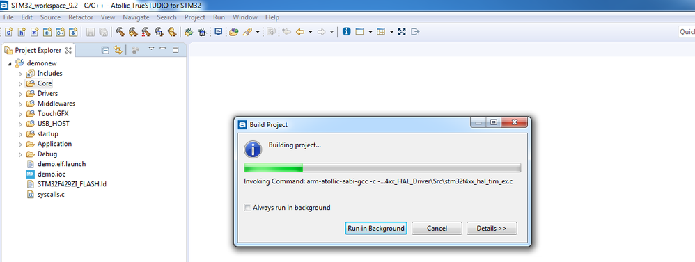

2019-01-16 10:30 PM
Thank you very much for the answer.
Now my project has successfully built and running on the board.
Will still have to make some changes in graphics settings to get the best image result, though.
