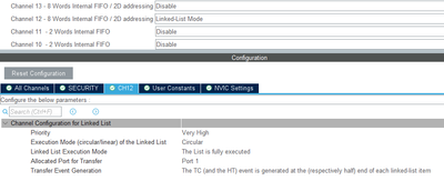

I setup GPDMA channel 12 for the linked list:

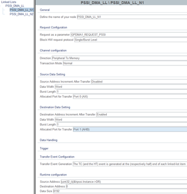

And here is the linked list with two nodes N1 and N2 configured exactly the same (except name):

/* Build PSSI_DMA_LL_N1 Node */
ret |= HAL_DMAEx_List_BuildNode(&pNodeConfig, &PSSI_DMA_LL_N1);
/* Insert PSSI_DMA_LL_N1 to Queue */
ret |= HAL_DMAEx_List_InsertNode_Tail(&PSSI_DMA_LL, &PSSI_DMA_LL_N1);
/* Set node configuration ################################################*/
/* Build PSSI_DMA_LL_N2 Node */
ret |= HAL_DMAEx_List_BuildNode(&pNodeConfig, &PSSI_DMA_LL_N2);
/* Insert PSSI_DMA_LL_N2 to Queue */
ret |= HAL_DMAEx_List_InsertNode_Tail(&PSSI_DMA_LL, &PSSI_DMA_LL_N2);
ret |= HAL_DMAEx_List_SetCircularModeConfig(&PSSI_DMA_LL, &PSSI_DMA_LL_N1);
return ret;

Another, and currently even bigger problem is that the linked list does not circulate. By adding a simple incrementing integer into transfer completion callback and printing it out in the main loop I see only 1 and 2. Using debug breakpoints seems to break transfers, that's why I used non-invasive method. I do not get DMA error callbacks. I have seen data reach RAM, but not always.
Reference manual RM04777 chapter 12.4.3 "GPDMA circular buffering with linked-list programming" is creating more questions. It seems to suggest that only the second node should loop and half-transfer completion interrupts should be enabled. I don't grasp that idea...
