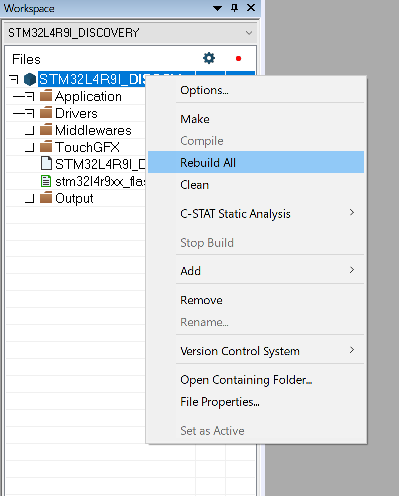

You have to compile your project to see your .map file.
If you are using STM32CubeIDE, please press the "Build" button :
If you use EWARM, press "Rebuild all" after right-clicking your project name :
If it compiles successfully, you'll be able to access your map file.

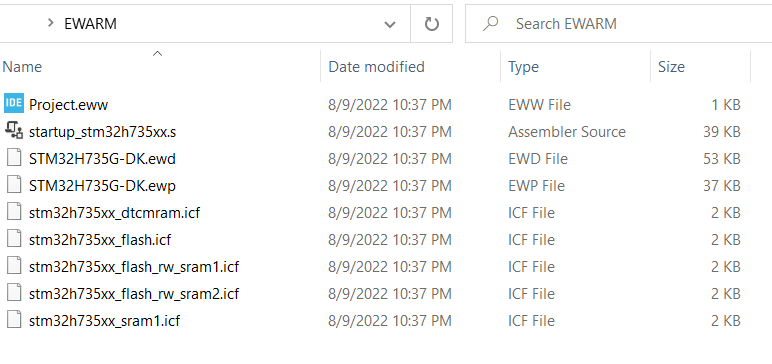

2022-08-09 6:49 PM
Thank you @Yoann KLEIN
Please note the EWARM directory in my case (gfx 4.20.0)
2022-08-10 1:28 AM
