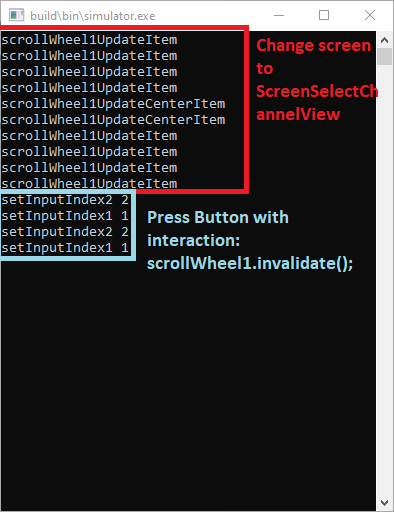

2022-03-06 11:00 PM
2022-03-07 2:07 AM
Thank you again for your fast replies. I searched a lot and so I don't have any way except asking here.
I already did what you say. This is my button action:
void ScreenSelectChannelView::setInputIndex1()
Temp_Input_Index = 1;
scrollWheel1.invalidate();
touchgfx_printf("setInputIndex1 %d \r\n", Temp_Input_Index);
}I expect calling function "scrollWheel1UpdateItem " by pressing the button but touchgfx_printf shows it doesn't run:In Red section we see scrollWheel1UpdateItem and scrollWheel1UpdateCenterItem are called when I change the screen to ScreenSelectChannel. But pressing buttons doesn't call those functions.
