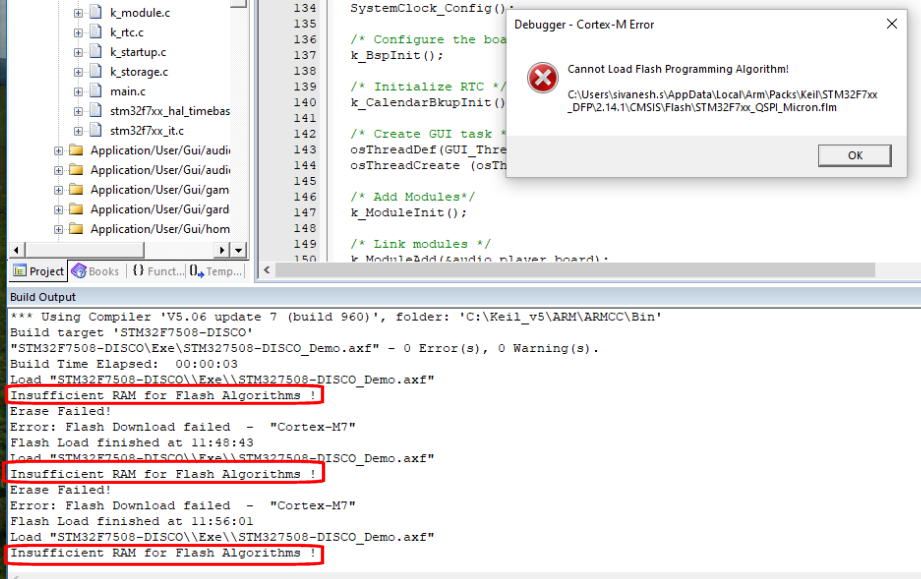

*I am using stm32f7508-DK ,
*Under ==>
[ STM32Cube\Repository\STM32Cube_FW_F7_V1.16.0\Projects\
STM32F7508-DISCO->Demonstrations->STemWin ]
*It gives error img attached ,
* Expect help to resolve this part.

The 'Build Output' window seems to be giving you the reason why it failed to load Flash Algorithms:

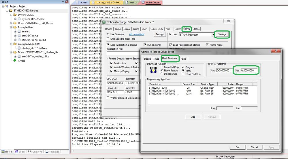

Go into settings for Debugger are and increase the RAM size allocated, perhaps to 0xE000 from 0x1000 or whatever
