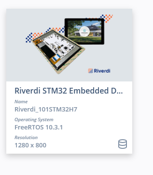

I am generating my project using the model selected in the TouchGFX application. From there, I import it into the STM32CubeIDE workspace. However, when I try to upload the project either from TouchGFX or STM32CubeIDE, I
get the this error.This is the model I've been using.
Model
