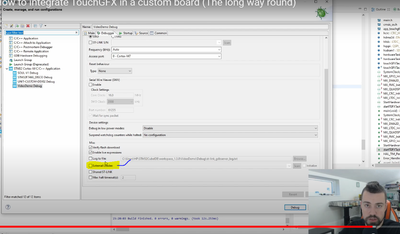

I refer this YouTube video: https://youtu.be/SRQD8JMeg_k?si=bGmAo4KQ7zLAYZx5
This video displays an external load checkbox while he debugs the project. But this isn't displayed in my project.

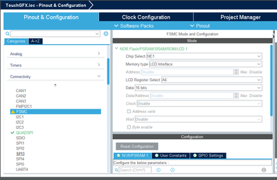

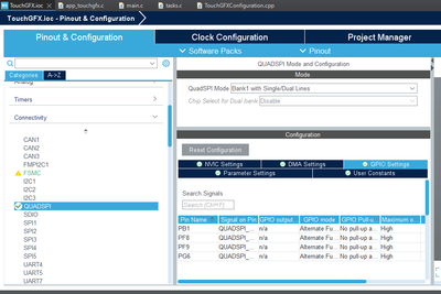

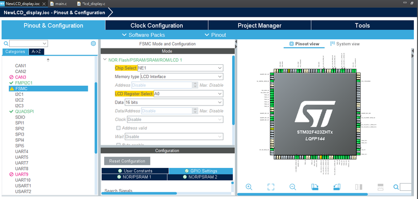

This my pinout & Config

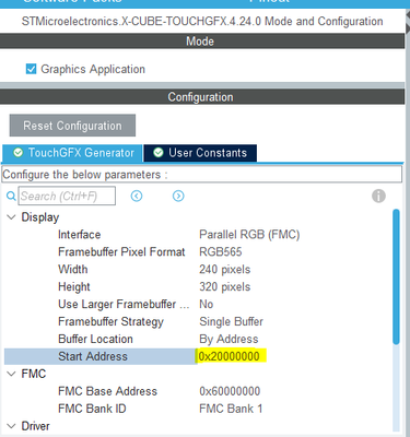

In STM32CubeIDE -> .ioc file -> X-CUBE-TOUCHGFX -> Display -> Buffer location- By Address and Start address-I put 0x20000000. This is a SRAM1 memory. This is correct or not. If not means what I choose.
