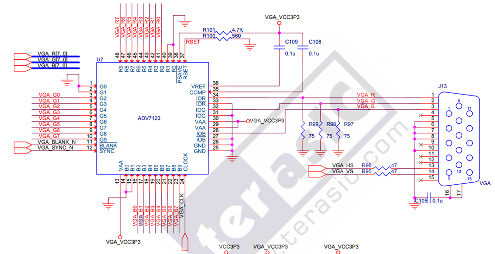

Clone device GM7123
https://www.youtube.com/watch?v=jOc74zG4IS4
https://medium.com/@jeremysee_2/designing-a-24-bit-vga-adapter-acbcccd3258e

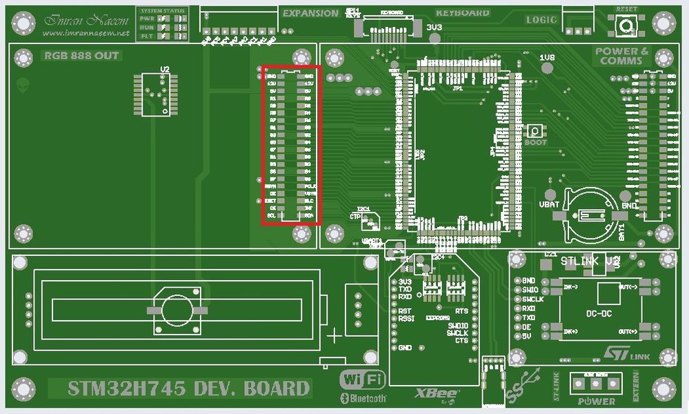

below is the render of my H745 Mother Board. The RGB888 Header is highlighted in red box.
the header has RGB888 and also I2C for future options .
My first experiment with this board was with Single Channel LVDS type TFTs .

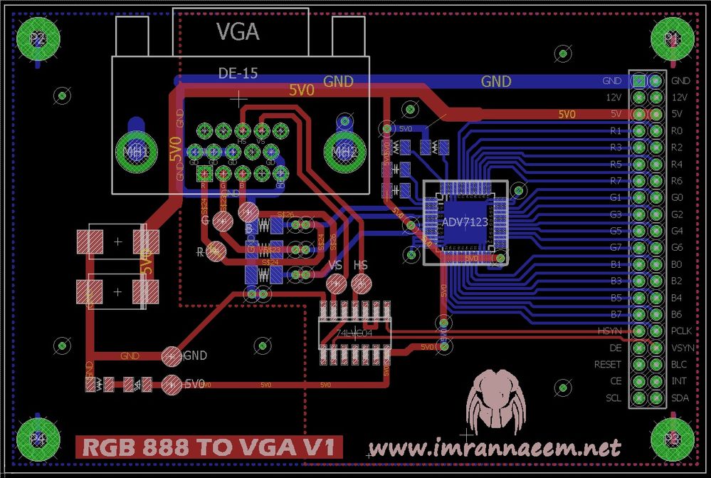

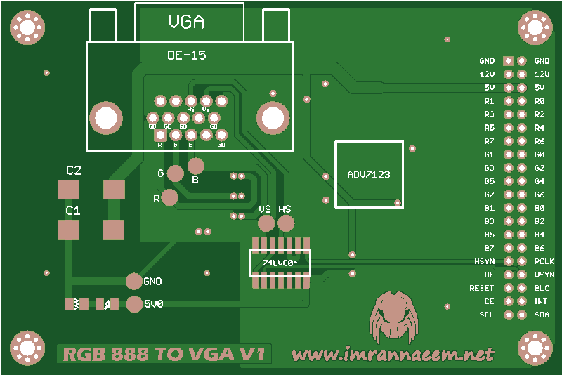

ABOUT VGA CARD...
It was quit simple to port ADV7123 .
Above are screen shot of pcb design and its render.
I added 74LVC04 on HSync & VSync signals.
Configuration LTDC in MX .
I used standard display timings found on google for VGA interface.
But it took few weeks to trouble-shoot my VGA board and fine tune for flicker free display. (well ,, my job is like mechatronics engineering and hardly i spare little time on weekends )

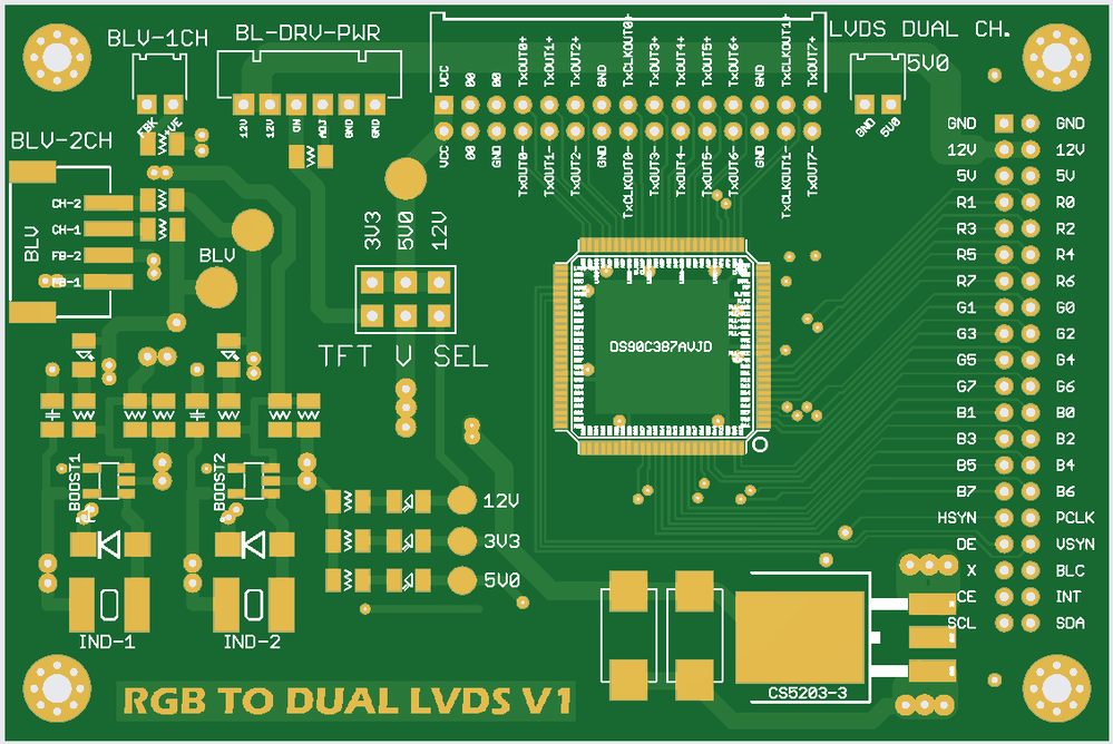

Here is my Modular Dual Channel RGB888 to LVDS board which I will order soon.
With this card , I will be able to interface Laptop TFTs with higher resolutions.
:beaming_face_with_smiling_eyes::beaming_face_with_smiling_eyes::beaming_face_with_smiling_eyes:8)8)8)

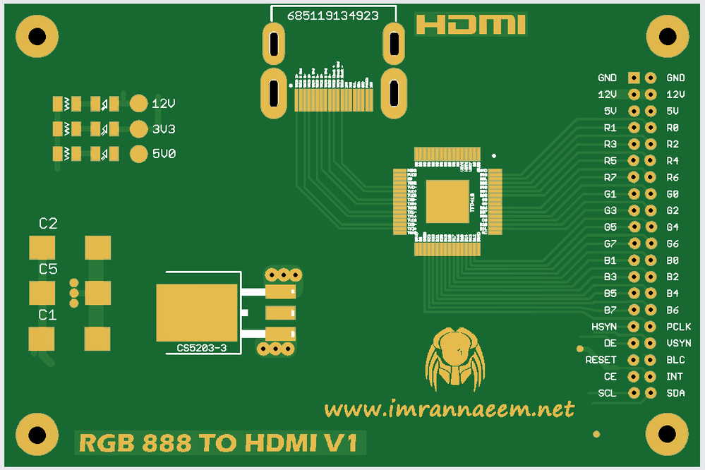

Here is on-going pcb design .
RGB888 to HDMI 8)8)
