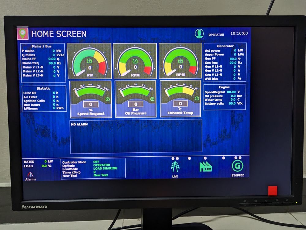

2024-08-12 10:33 AM
Hi @ferro ...
Here is my latest TouchGFX Experiment with Standard FHD LCD Monitor .
My H745 Dev-board connected to standard lcd over VGA cable and above is the result.
STM32H745 >> ADV7123 >> VGA-CABLE >> FHD-MONITOR :beaming_face_with_smiling_eyes::beaming_face_with_smiling_eyes::beaming_face_with_smiling_eyes:8)8)8)
Regards
I.N
2024-08-12 10:51 AM - edited 2024-08-12 10:53 AM
Your modular design is an excellent approach.
More details on the VGA card please..
BridgeTek? https://brtchip.com/wp-content/uploads/Support/Documentation/Datasheets/ICs/EVE/DS_BT815_6.pdf
Sorry, missed the ADV7123 reference, that DAC's got some head room
https://www.analog.com/en/products/adv7123.html
