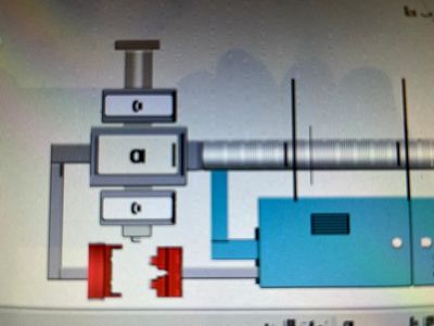

I have a custom board with STM32H743 and working on a project by TouchGFX 4.24. When the device power on or reset, some times I have a mixed image including numbers, pictures and ..., which I attached the image... and some times every thing is Ok after reset or power on. I have another project by TouchGFX on this board, which it always works fine.
Please help me with this, thanks.

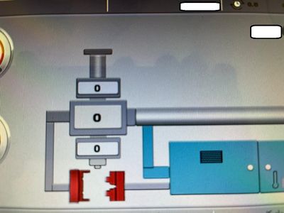

@MHaji.1 wrote:
Please post the corresponding image of what the screen should look like.
Note that you can paste the image into the post - where we can see it - rather than attaching it (where we can't).

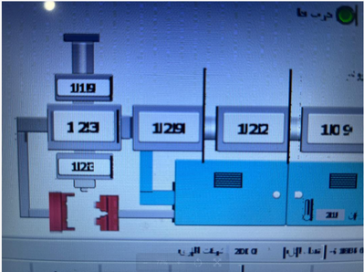

Hi Andrew,
Thank you for reply.
As you see in the picture, The numbers are readable and the picture is correct, but in last one all screen is distorted.

No, The corrupted one is installed on a mold machine and the numbers are related to device, Here is a picture with the same as last pic which I sent:
As you see, There are some weird lines and numbers are corrupted, picture has lot of noise and...
