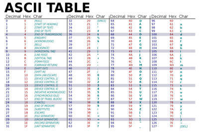

2023-08-14 6:48 AM
Apparently this is just a character converter. It doesn't seem to be applicable to different languages.
Binary Translator Convert Binary code to Text (English or ASCII) and vice versa
Try searching for some Google translator online API.
