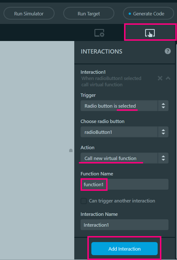

Hello @MM.22aino,
I recommend you using a radio button, you add it in the GUI first, then create an interaction on the right section as presented in the photo attached.
In the menu, you can select "Radio button is selected" or " Radio button is deselected " as Trigger, then you have the action menu, you can either select one of the proposed options or select “Call new virtual function�? and develop it in the code generated by TouchGFX in the STM32CubeIDE.
Please note that the base files should not be modified since they are generated directly from the created interface and widgets.
Chahinez.
