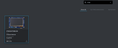

In TouchGFX Designer, when I type "h750", the only option is the STM32H750-dk board:
So I don't know how you select it.
