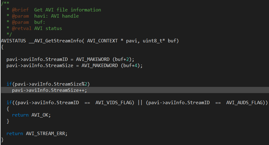

And I have built the code for my own board test, but I got some error on it.
When I debug the code, it always get in HardFault at StreamSize like the image below.
But if I change the size format from uint32_t to uint16_t, it will pass through ,even I know it is not correct.
Is there anyone can help to solve this?

What memory address is pavi->aviInfo.StreamSize at? Is it pointing to a valid memory address? Seems odd that line would cause a hard fault. Examine your SCB registers in the hard fault to determine if that line really is the cause.

pavi->aviInfo.StreamSize is at 0x24000000(AXI RAM)
And I also check the address , It is exist the data same as file.
But just annoyed why the uint32_t will effect the HardFault problem.
Is that something wrong about the Official Code or am I lose some setting ?

Change the StreamSize uint32_t to uint16_t
Or change the AVI_MAKEDWORD (uint16_t) , now is uint32_t
And What does the exact memory address mean?
Do you mean the data where to storage?
This is the debug mode show the address .
