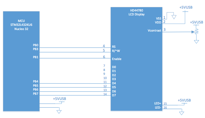

I have a thermistor attached to the nucleo-l432kc board and a C program that obtains the temperature and prints it on a terminal display, an LCD display, and lights up a corresponding colour of an RGB LED. I initially had my LCD set up to 3.3V (because that is what our thermistor is supposed to be powered by), and didn't have any issues with the output of temperature values in terms of printing, LCD display, or the LED that turns on. But now that I have changed the LCD input voltage to 5V to increase the contrast (using a potentiometer from the 5V), there are issues with the output of temperature that I am unsure of how to fix. I've attached a photo of the LCD and nucleo-l432kc schematic setup. Also worth noting, I've tried to change it back to the 3.3V I initially used and it just displays the wrong temp for the entire duration, not just the first loop, still being about 2-3 degrees lower.

Any suggestions for how I can fix this problem of a single incorrect value printing first? I'm assuming it's because of the LCD display.
