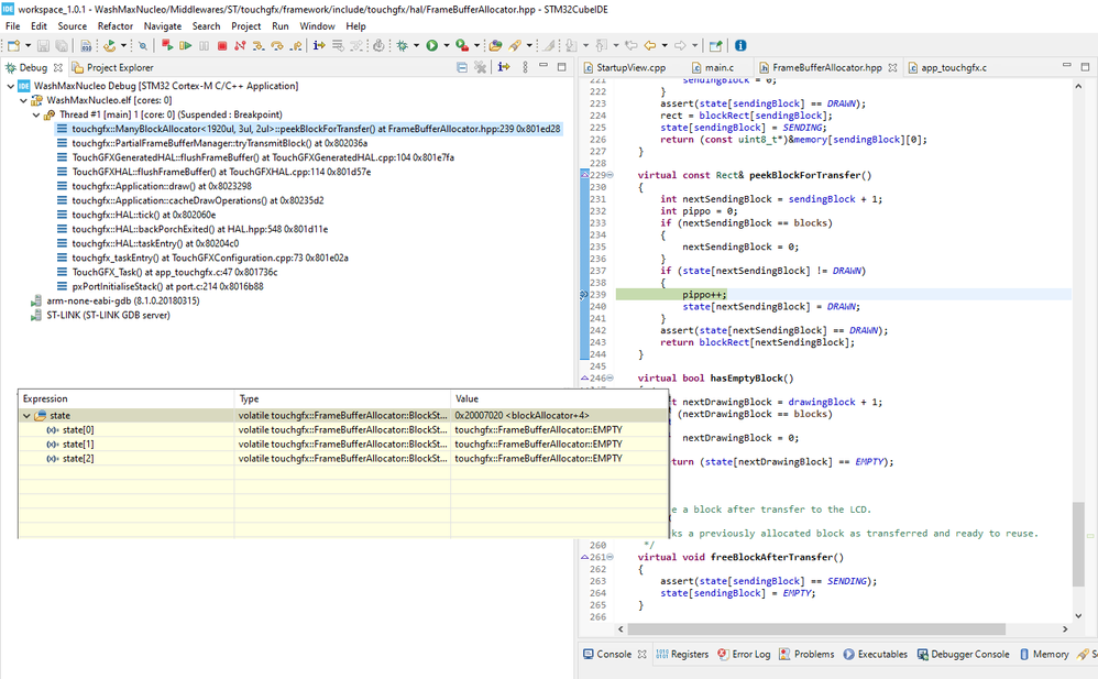

2021-01-03 11:20 PM
Hi and happy New Year !
@Flemming Gram CHRISTENSEN I have attached the image with the stack and the contents of the state vector.
Thanks
2021-01-05 7:32 AM
Thanks. We're trying to reproduce is here - This is not the first time we've heard about someone having issues with PFB and RTOS.
2021-01-13 12:27 AM
Update:
We found a logic bug that would cause this issue. We have a fix ready for 4.16.1 which should be out end of January.
/Martin
