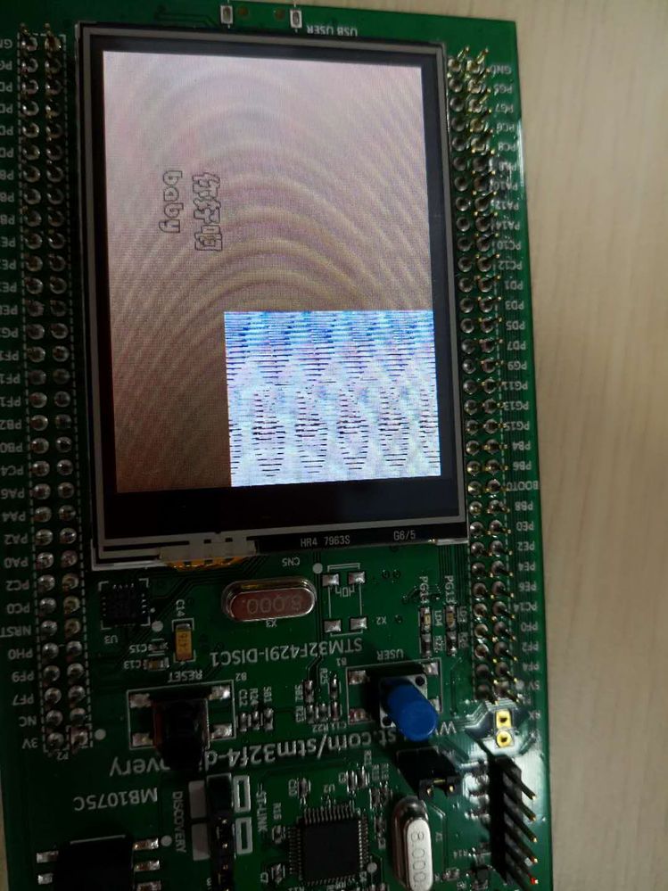

so i changed my code calling that function changing that parameter, and the effective orientation of the simulator changed, but the problems are the images
as you can see the images are rotated if are square, and just a mess if are rectangle.

When you don't change the hardware configuration to draw natively how you want to, you must do so in software - That's what we're doing right now with e.g. telling the image manager to rotate the images when it generates code for an image.
Yes, you need to recompile your application either way. They're two different applications, more or less. What i'm saying is that you need to maintain either two applications or just one where your screens check for what the orientation is - Either through code (if(Hal::getInstance()->getDisplayOrientation()==...) which would add support for dynamic rotation - or by using preprocessor directives #ifdef PORTRAIT or something like that.

In regards to your issue: Go to the "Config" tab in the designer and you can specify "display orientation" of the application itself and also rotation for images.
