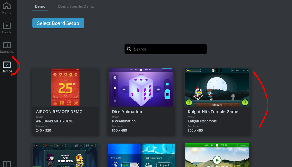

2023-03-06 1:51 AM
Where can I get the source code of Knight Hit Zombie game?
2023-03-06 4:12 PM
Used "TouchGfx Desinger" could generate the source code of Knight Hit Zombie game.
2023-03-06 11:25 PM
Thanks you, I don't know it's an example already available in ToughGFX.
2023-03-06 11:28 PM
You can find it in the Demos tab in TouchGFX Designer.
/Romain
2023-03-07 12:15 AM
Thanks you, I got it.
