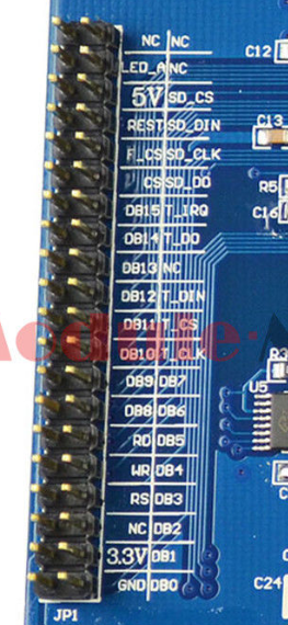

Please tell from where you get the TE signal ..On my ssd1963 7 inch display i do not see a pin with that
2020-08-01 2:54 PM
Which exactly model is this? Mine has a TE pin on header.

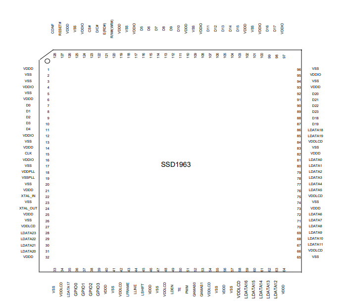

If you are good at soldering and wanna risk it, **** Effect signal is pin number 50 on SSD1963. It may be floating on yours, I don't know. Maybe someone else could have a better idea. If you discover how to make it work using DMA transfers, please, let me know.
