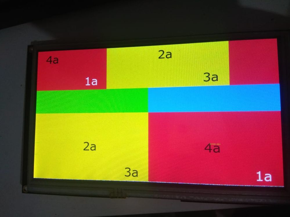

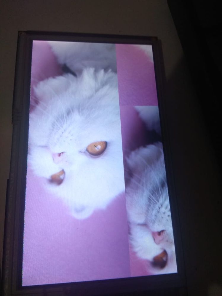

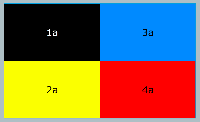

Someone could please help me to identify why my image is being drawn liek this? I suspect my buffer is the problem.
Designer:
Display:
Designer:
Display:
May the cause of this be here?

}How much this should be advancing the buffer? Actually for each loop it's advancing 1600 (0x640). I don't know why it's not working as expected.
After initialization I can write to display and everything works fine. I can clear screen, draw lines, draw rects and filled rects. I guess it means my problem isn't related to the display initialization or drawing to the FSMC bus. TouchGFX is drawing line by line until the display is filled as expected. What is wrong? Any thoughts on this?
