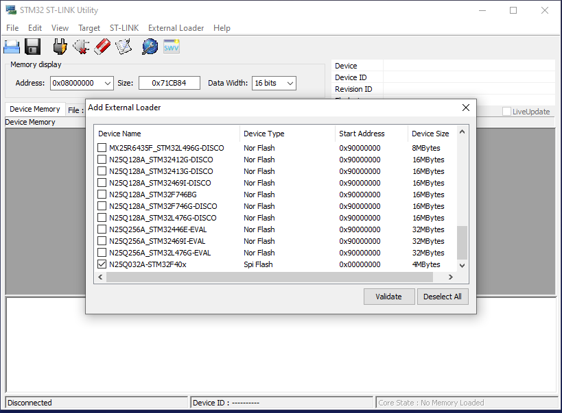

I don't know how to make an external flash loader. But I found one spi flash loader in ST utility external loaders. There should have a way to make one.
Maybe post a new question to ask about this.
Hope you solve this problem.
2021-02-19 3:18 PM
It is basically a byte field in the loader header that specifies it being an SPI_FLASH
I'd need to know the pins and SPIx involved to port the W25Q128 loader over to an F4
