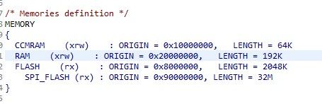

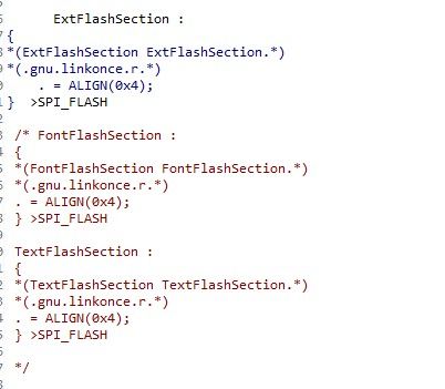

2021-02-16 6:37 AM
Firstly, thank you for your reply. I made the adjustments in the id file as in the pictures. The code is being compiled, but the pictures that should be on the 7 inch screen are not visible. I don't know how to set the external flash to memory mapped mode. Can you help me ?

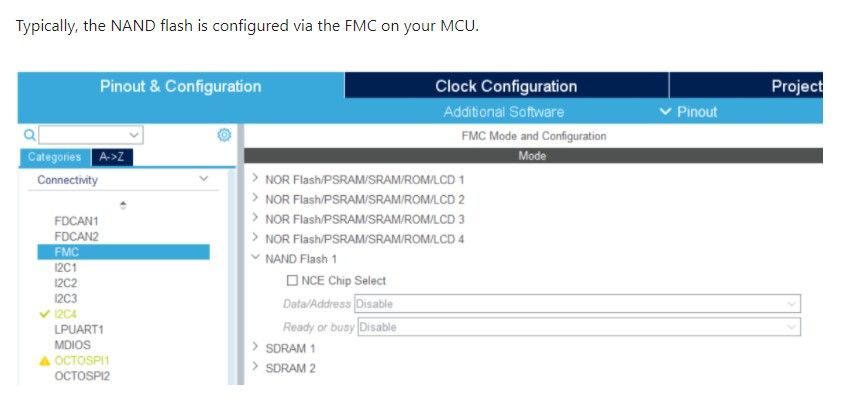

2021-02-16 10:49 PM
The block mode you said here is configured with FMC. The flash I used is W25Q128. Typical SPI configured with STM32F429 mcu. I'm very confused.

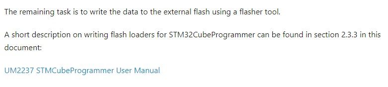

2021-02-18 12:19 AM
@Community member Thank you for your answer. I have to use F429 in this project.
@zzzzz Thank you for your answer. When I browsed through the manuals on TGFX site, I learned that I need to write flashloader. There is an example of writing flashloader for QSPI on the site. But I couldn't see a flashloader example for SPI. It will be easier for me to learn if there is at least an example. I don't know how to write this flashloader.
