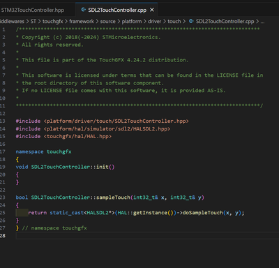

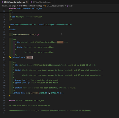

I have not seen a method to de init the touch controller :
You could either create a de-init method and call it SDL2TouchController :
Or you could try to de init the SPI that is used for it, then re init the SPI and the touch controller.
