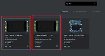

Hello @Julian_ ,
Yes it seems that this is the right driver.
When you create your project in TouchGFX Designer, do you select the correct revision? There was a board revision, so you have to select the correct TBS for your board :

Thanks for your answer Gaetan
I used the AU1 version for the newest revision of the board, but we also use the old revision board. The difference is in my opinion only the LCD driver so we can either load the driver for the old LCD or the new LCD. The drivers for the touchpanel ft6x06 should be the same because it is also compatible to FT6336G (I already checked this on the release notes for this driver).
