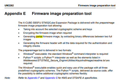

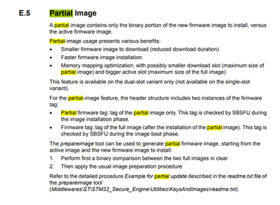

I've got a question about the documentation and operation of the SBSFU partial image generation.
The partial image feature of the image preparation tool is documented in the appendix of the getting started document here: https://www.st.com/resource/en/user_manual/um2262-getting-started-with-the-xcubesbsfu-stm32cube-expansion-package-stmicroelectronics.pdf
See here for the relevant portions of documentation:
