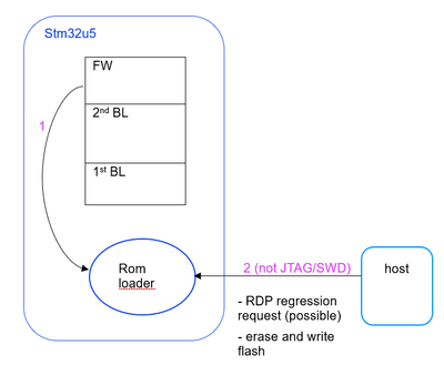

2024-06-25 3:52 PM
Hello @Jocelyn RICARD ,
thanks a lot for the reply!
As previously mentioned, I am developing a concept that can update the 1st Bootloader, but it still has several open issues.
The brief process is shown in the following picture and includs two steps:
1. transition to ROM loader;
2. update either the 1st Bootloader or the whole image depending on demands.
Questions related to step1:
a) Are the following two methods of forcing the system into ROM loader correct? Assuming BOOT_LOCK option byte is not set.
(1) Change the boot entry to ROM loader using boot0 pin and trigger a reset.
(2) Jump to ROM loader from application using the solution at:
b) Can the above two methods always be used successfully, regardless of the TZEN and RDP configurations?
Questions related to step2:
c) Can the Regression of RDP from 1 to 0 via ROM loader (through a non-JTAG interface) ONLY be done without OEM1 key, i.e., in rdp legacy mode?
General Questions :
d) Am I correct in understanding that the 1st bootloader, when BOOT_LOCK is not set, isn't secure boot, even though it can verify the integrity and authentication of the next stage image?
Thank you in advance.
Best regards
2024-06-26 6:37 AM
Hello @xj ,
Yes with TZ disabled. When TZ is enabled the 1) is OK but the 2) can only be done from secure application and after setting up the platform so that ROM loader that is unsecure can run. I don't know if is was already done.
OEM1 key when provisioned is mandatory to be able to perform the regression. And it that case, regression can only be done through JTAG. So, answer is yes
General Questions :d) Am I correct in understanding that the 1st bootloader, when BOOT_LOCK is not set, isn't secure boot, even though it can verify the integrity and authentication of the next stage image?
As long as you can change the boot address, you can bypass this verification.
Best regards
Jocelyn
