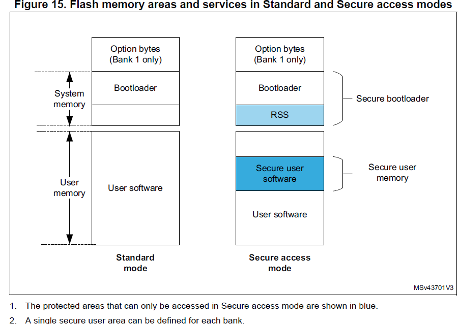

I have one quick question, is the Secure Bootloader whatever, OEM built with help of Secure Engine & SBSFU together, is it going to sit in System Memory of Flash as mentioned below ??
I think, System Memory accessible by only ST right ??
So where is the location of OEM Secure Bootloader flashed for one time ?? is it on Bank1 Sector 1 ?? then what resides in System Memory Boot location ??

For STM32H753, the Unique Entry Point is in System Flash and you cannot change this code that will jump into the secure user memory area in user flash containing the X-CUBE-SBSFU.
X-CUBE-SBSFU goes in user flash so you can modify the code and flash your own version of this OEM bootloader. Nevertheless, it is protected by secure memory so you won't have runtime secure services.
